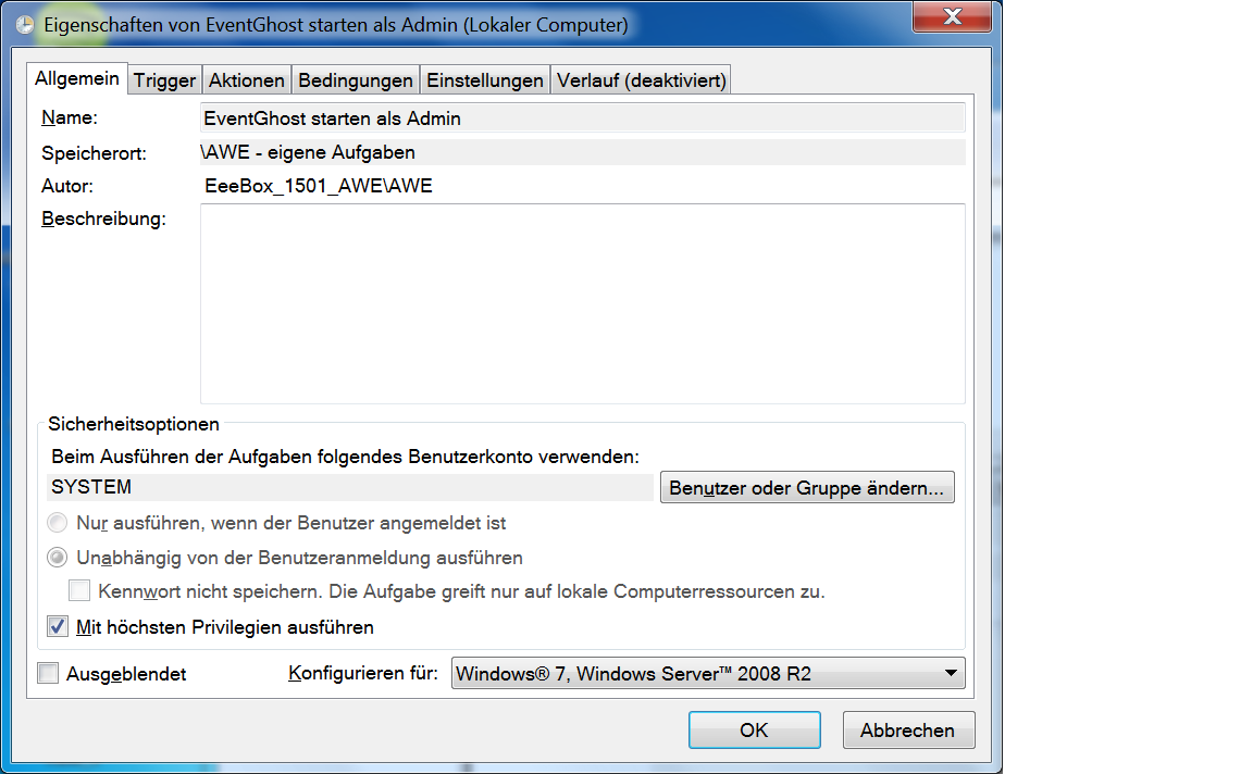

I set up the Task Scheduler according to your recommendations, as far as you reported them. Now EventGhost starts after the logon automatically, runs under the SYSTEM user. But the systray Icon does not appear and it does not react to events.
I have to run EventGhost as Admin, because the DVBViewer plugin requires this.
Atached are my Settings in the Task Scheduler (sorry for zip, could not upload several images).

What are your settings at the "Generals" tab`? I suppose my problem is here.
I have user "SYSTEM", run without logon, with highest privileges. Attached is a screenshot (German) the layout is similar to the english version.
My environment is the following:
I'm running DVBViewer (a live TV application) under the Windows "Guest" account with restricted privileges. Unfortunately the DVBViewer plugin for EG needs to run with Admin privileges. So I'm trying to automatically start EG as Admin, when the Guest session starts.

awehring wrote:Woww, great, thank you ! :D
I will try this tonight (CET).
When I configured my task, I just left that setting to its default value, which is the name of the user account I log into. Not sure why you would need to change that, unless you're trying to configure a task for other accounts you created in Windows.
If you're just using this for the main account, leave it to its default value. If you need to configure it for other guest accounts you created, then set to what those accounts are named.
