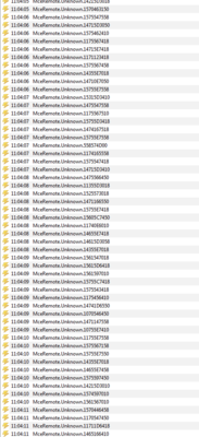

The fact that the MCE plug-in recognizes actual MCE remote signals, such as MceRemote.Mce.Num2, doesn't mean that you're stuck with that function. You can use that Event to trigger any EG function. So whether EG sees MceRemote.Mce.Num2, or you manage to disable that recognition and EG sees something like MceRemote.Unknown.1342C8 makes no difference whatsoever.MartyMc wrote:I thought this was going to be easy, I figured EG can overwrite the MCE remote's hard-coded commands such as guide, green button, video, music, etc.. but it seems there is no way to get rid of those functions.
Re: WMC + XBMC using MCE Remote (eHome Receiver)
Yes, that's correct, I assigned a few functions to EG using .Unknown, however I am unable to use directional keys or keys that I need to press in succession. While EG accepts MceRemote.Mce.Num2 commands pretty fast, it requires a small pause before you can press MceRemote.Unknown.1342C8 again. If you have a remote lying around, an old TV remote, or something that's not sending MCE commands, try it.kkl wrote: The fact that the MCE plug-in recognizes actual MCE remote signals, such as MceRemote.Mce.Num2, doesn't mean that you're stuck with that function. You can use that Event to trigger any EG function. So whether EG sees MceRemote.Mce.Num2, or you manage to disable that recognition and EG sees something like MceRemote.Unknown.1342C8 makes no difference whatsoever.
By the way, I take what I say back in above quote, running Win 7 Pro, I installed win 7 Mce plugin first, then I installed regular non win 7 plugin, clicked on disable HID, and then removed the plugin, this disables WMC hard-coded commands. If I want them enabled, I just install non-Win7 plugin, and check then uncheck HID, then I remove the plugin, this enables it.MartyMc wrote:I thought this was going to be easy, I figured EG can overwrite the MCE remote's hard-coded commands such as guide, green button, video, music, etc.. but it seems there is no way to get rid of those functions.
I don't seem to have that problem as you can see from my screenshot. But even if you do, why not just use MceRemote.Mce.Down etc. for the direction keys? The autorepeat in my .xml works well with it too.MartyMc wrote: Yes, that's correct, I assigned a few functions to EG using .Unknown, however I am unable to use directional keys or keys that I need to press in succession. While EG accepts MceRemote.Mce.Num2 commands pretty fast, it requires a small pause before you can press MceRemote.Unknown.1342C8 again. If you have a remote lying around, an old TV remote, or something that's not sending MCE commands, try it.
