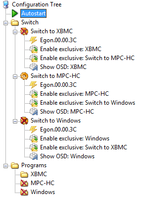

Here is a simple example:
You need to reserve one button for toggle your "profiles" (programs).
In the example, this is the event Egon.00.00.3C.
You will certainly have a different event. But you must place it in all three macros.
The macros can also contain command to start the corresponding program.
SwitchExample.xml
(2.03 KiB) Downloaded 222 times

Thanks Pako. The example preview really helps trying to understand what is done by Evenghost.
If I understand correct the PROGRAMS folder with the 3 subfolders XBMC, MPC-HC and WINDOWS are the folders I already made myself correct?
Ok, I understand that I want a RED CROSS on 2 program subfolders in order to only get 1 program subfolder to work.
The SWITCH folder is the folder that should take care of this correct?
My first question is, if I need one button to toggle between my programs, how do I know exactly on which working program evenghost acts at that moment? Isn t it possible in some way to do this automatically (I can imagine that there is a way maybe that Evenghost somehow knows I m in XBMC, MPC-HC or WINDOWS (desktop) so Evenghost switches automatically to that program and disable the 2 other programs?).
What I also do understand is that eg. 'Switch to XBMC' has 'Enable exclusive: XBMC' in it. This makes sense because Evenghost then exclusively uses only the XBMC program folder and disables all other program folders right? What I don t understand is the other 'Enable exclusive', in the macro example 'Switch to XBMC' 'Enable exclusive: Switch to MPC-HC'. Why do I want to switch to MPC-HC if I want the XBMC macro to work exclusive??
And also, where is the Show OSD thing for?
Lot of new questions m8. Thumbs up for your help already!!

@PAKO:
I made the configuration you suggested and it works like a charm! Now I completely understand the switch with all macros etc!!
The problem however is that both XBMC and MPC-HC work in some kind of exclusive screen mode so I don t get to see the OSD when toggling. So I might just program 3 buttons on my remote, 1 for MPC-HC, 1 for XBMC and 1 for WINDOWS.
