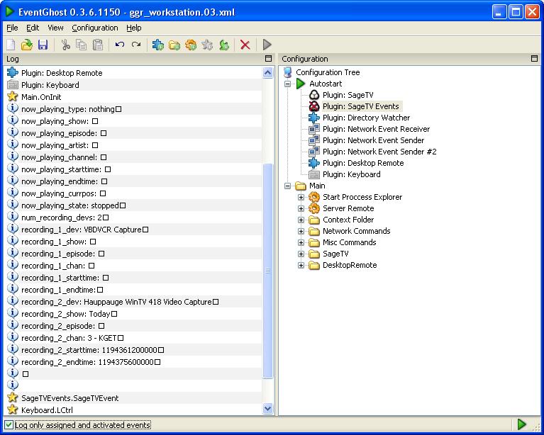

here is what the output looks like

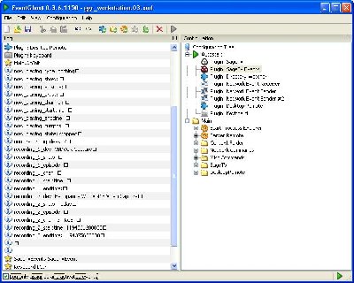

nightrader_
Posts: 13
Joined: Mon Nov 05, 2007 12:19 am
Re: Help writing a plugin
Post by nightrader_ »
OK, done, the SageTVEvents plugin is done (only tested by me) :D .
