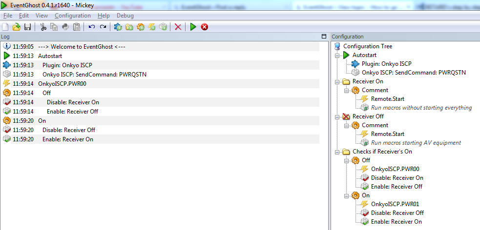

Re: How to go about writing an If Then Script
This sort of thing should do the trick:
Mickey.xml
(1.76 KiB) Downloaded 119 times

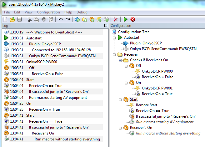

You're welcome. I was intrigued by kkl's method, so here's another way. I thought I may as well share my fiddling. :)
I'm not sure which is the cleanest, but both seem to work.
Mickey2.xml
(1.74 KiB) Downloaded 126 times
