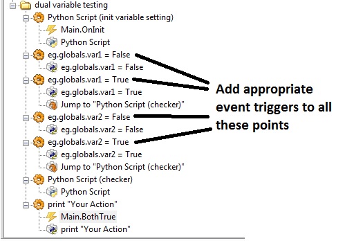

Hello!
I'm quite new at this whole thing with eventghost, and what I'm really having issues with is Python. I've checked the forums already but i can't make sense of Pythin solutions being mixed with normal writing.
So I was just wondering if I could get som help.
So i want a macro to be triggered when both me and my girlfriend are not at home.
I've come so far that I've installed pvar.
And our "home" and "gone" statuses are termined my ping's.
When I leave, the variable is set to Adminhome = False and when my girl leaves it is set to Girlfriendhome=False.
So when both these are false i want event "Main.gone" to be triggerd.
If it is possible i would be soooo happy if i could have a python-script for this so i can use it for other things aswell (chopping up and modifying code has always been my thing :P)
Thanks in advance!

You can use 2 eg.globals variables and do something like this:
This is setup so when ever both are True the TriggerEvent BothTrue is called within the checker script. The checker is called each time one of the variables are triggered to be True.
dual variable testing.xml
(1.96 KiB) Downloaded 240 times

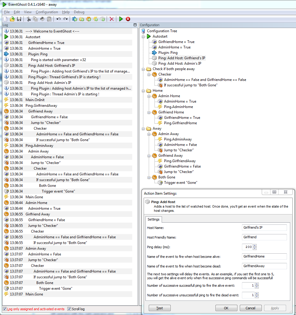

Re: 2 events trigger 1 macro
I had a go too :)
away.xml
(2.58 KiB) Downloaded 218 times

WOW! Thanks guys! did'nt need that much python as i thought at all there!
HUGE thanks to the both of you! :)
Think i got this mother all up and running now! :D
