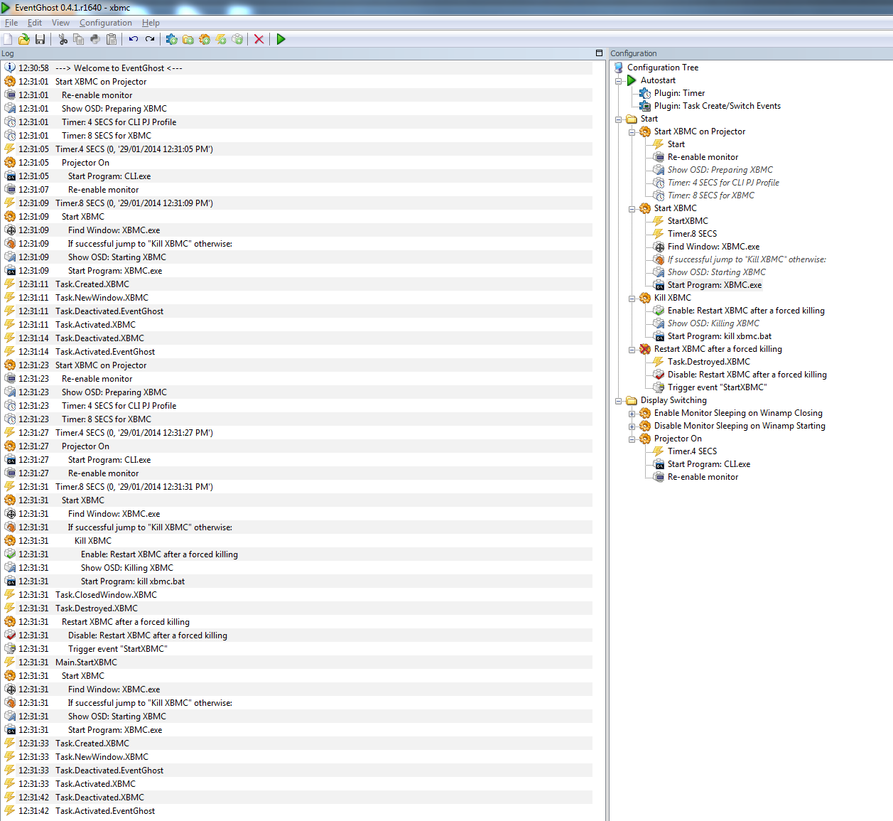

Ideally you would want to use the RSÔÇô232 of your TV to detect, switch on, and choose inputs.
I've attached an example where my receiver is switched to a particular input and it selects the HDMI audio, rather than the computer speakers.
My projector doesn't have RS-232 so occasionally I lose sequence as well, and XBMC doesn't like already being started, and then being switched from computer screen to projector.
To get around this I've made a little sequence in EventGhost that kills XBMC if it is already running, which is in the.xml as well.
Using the RS232 http://www.harmankardon.com/resources/B ... otocol.pdf for your receiver would be the best way too.
viewtopic.php?f=5&t=2839 has some ideas that might help too, but they won't help with knowing whether the correct input is selected, just if something is connected.
- kill xbmc.rar
- (1.41 KiB) Downloaded 82 times
