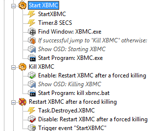

Hi folks, I am using a button press for closing XBMC, a wait, then using a cmd for task killing, then reopening XBMC (I have had to experiment with setting a longer time inbetween kill and open, as 5 seconds is not working any more to fix the issue of "xbmc outputs to 1024x768 default resolution if the PC is turned on while the TV is turned off". For some reason with gotham, 5 seconds isn't enough time for the tv resolution to reset. This of course can be fixed by the win devs of XBMC but that is another story)
I would like to expand on this with the following:
if xbmc is running = run commands to close xbmc, task kill, launch xbmc
if xbmc is not running = command to just open xbmc
is this possible?
Thanks folks!
Re: Open/kill program based on if this or that

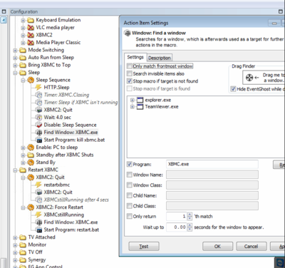

DeathAxe wrote: if xbmc is running = run commands to close xbmc, task kill, launch xbmc
Find window action. If it finds xbmc.exe, continue macro, and vice versa. You can also use the 'jump to' action in conjunction with the find window to do what you want.
Here's how I use it in a couple of places:
