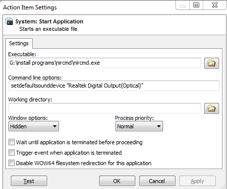

Might not help but nircmd.exe does a good job of setting the default audio device:
Re: Monitor changes in default audio device on Win 8.1?
Hello Blaher,
thank you, but I know about that as well..
Same problem here, Nircmd doesn't catch the events from windows, also it's not open source.
