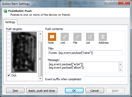

Here is the entire code of macros - you can use copy / paste directly into your configuration:
<EventGhost Version="1669">
    <Macro Name="PushBullet: Push" Expanded="True">
        <Event Name="iTunes.TrackChanged" />
            PushBullet.Push(0, [[u'Dick', u'[email protected]', 'user', True]], [u'iTunes: {eg.event.payload["name"]}', u'{eg.event.payload["artist"]}\n{eg.event.payload["album"]}'], u'')
It is obvious that you have to change the recipient.

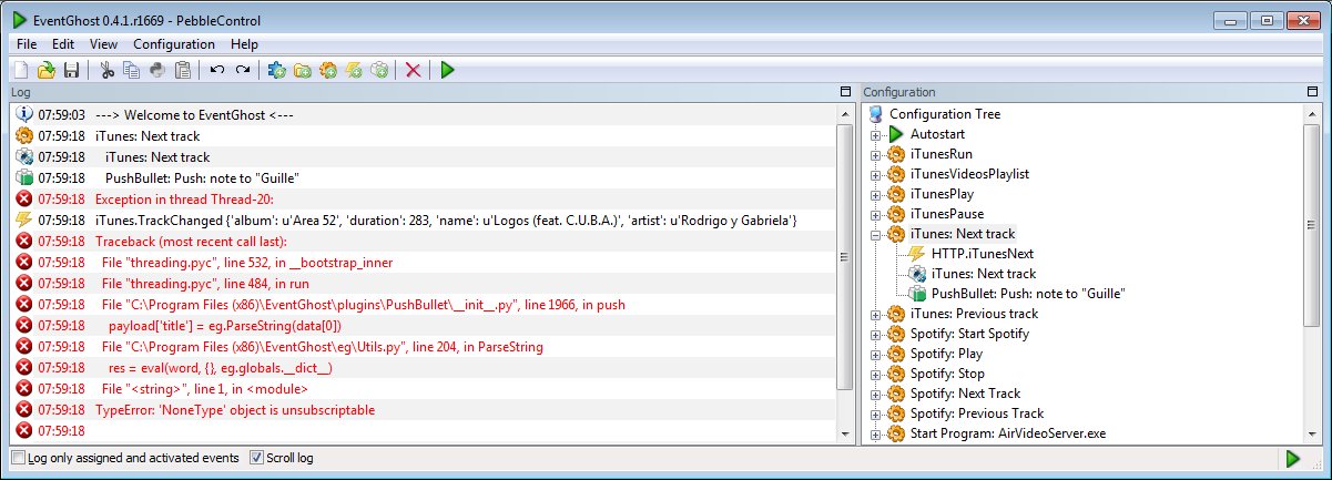

I tried your suggestion but didn't work. I get the following errors.
I found the relevant portion of the iTunes code where the TrackChanged event is fired. I noticed the "Payload" variable there is with an uppercase P, and tried that as well, but didn't work either.

Here's what my macro looks like right now:
    <Macro Name="iTunes: Next track" Expanded="True">
        <Event Name="HTTP.iTunesNext" />
            iTunes.Skip()
            PushBullet.Push(0, [[u'Guille', u'xxxxxxxxxxxxx', 'pc', True]],  [u'iTunes: {eg.event.payload["name"]}', u'{eg.event.payload["artist"]}\n{eg.event.payload["album"]}'], u'')
Again, thanks for the assistance and for your great work with the Pushbullet plugin.

Re: iTunes (plugin) and Pushbullet (plugin)?
You can not run a macro using the event iTunes.Next, because there is no payload.
You must use the event iTunes.TrackChanged.
Strictly speaking - you have to have two macros.
One macro for the action iTunes: Next track and second macro for the action PushBullet: Push.
