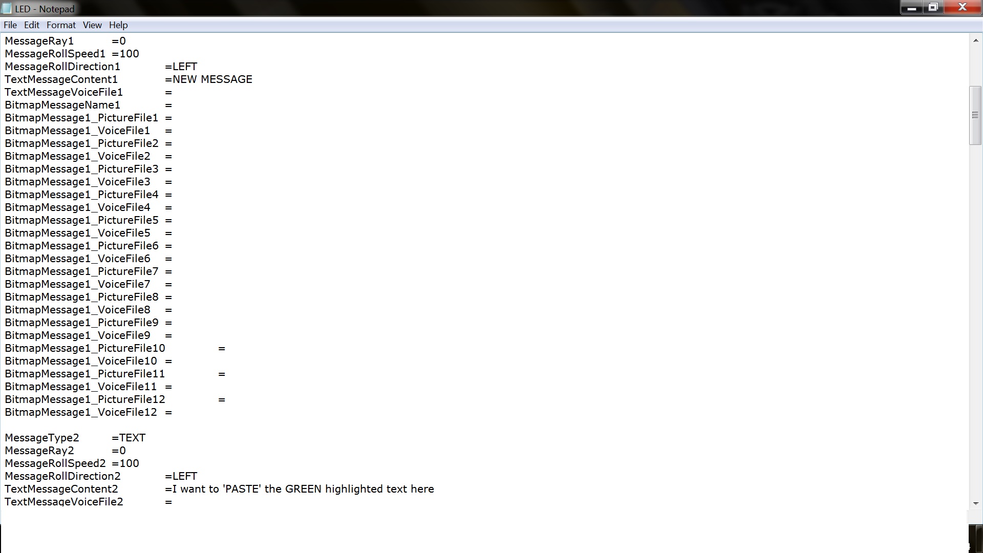

Is there a way to Copy the highlighted text (in green below), Paste it into a Configuration settings (.ini) file and Save it :?:
PushBullet.Note.Note [u' MESSAGE TEXT ', None, u'ujBpbiH1Dj2sjAy0gRhJdc', '', '2014-08-17 22:26:45']
Re: Challenge...
shaggy79 wrote:Is there a way to Copy the highlighted text (in green below) ...
It is of course possible.
Check out the ConfigParser - Work with configuration files.
Note: Highlighted part you get as eg.event.payload[0] (in python script) or {eg.event.payload[0]} (in dialogue).
shaggy79
Posts: 129
Re: Challenge...
Post by shaggy79 »
@Pako, 8)
Thanks for the reply,
But after reading through the link you sent, I still have NO idea how to do what I need. :?: :oops:
I have NO idea how to use 'Python' Or what you mean by.. :?:
in dialogue
I have Posted a screen capture of the (.ini) file I want to PASTE & SAVE to (I don't know if that will help explain it better).
Where I want to paste the HIGHLIGHTED text to
Cheers Paul. :oops:

shaggy79 wrote:I have NO idea how to use 'Python' Or what you mean by..
Write something into an ini file, it is not possible without using a script.
So if you need specific advice, you need to provide more information:
1) Attach ini file in which it is necessary to make an entry (I do not want a screenshot)
2) Specify the path to this file

The (.ini) file is located in :-
C:\Program Files\Dream Cheeky\LED Message
And here is the (.ini) file:-
LED.ini
(7.58 KiB) Downloaded 199 times
Thanks Again,
Paul. :oops:
Re: Challenge...
Here is the solution.
