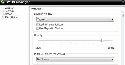

Is there a way to turn of that round iMon window? There is a settic "magnetic window" in the settings, and I assumed it was that one, but it keeps showing...

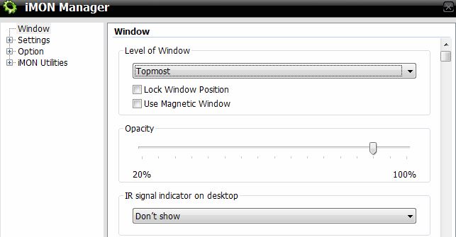

First of all, here my settings for the iMon Window:
[img]file://e:/Unbenannt.JPG[/img]
