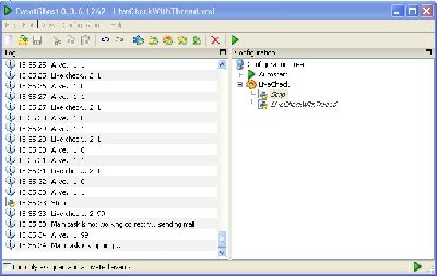

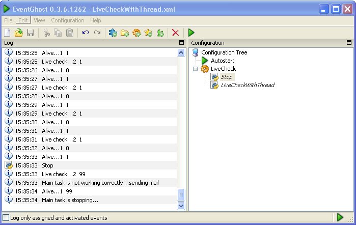

First start the "LiveCheckWithThread" script and you should see activities in the log.
Then stop the MainTask by starting the "Stop" script (it sets a eg.globals that is used as a condition flag to stop it)
