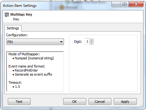

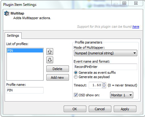

I am assuming your remote has numbers (0-9). These numbers will be used to enter the pin. If you don't have numbers on your remote, take a look at the SMS mode in Multitap.
1. Add Multitap plugin
2. Configure the plugin (see Figure 1)
3. Add a folder ("Pin Numbers") to hold the Multitap key macros
4. Add macros in this folder for each number (0-9) using Multitap Key macros (see Figure 2).
Note in the original screen, I only added a macro for the number 1.
5. Create a macro ("Enable: Pin Numbers") to enable the "Pin Numbers" folder (created in step # 3).
6. The action to trigger the "Enable: Pin Numbers" macro will be your RECORD button.
7. Associate the number buttons from your remote to each Multitap Key macro (0-9).
8. Press the number buttons on your remote to create a PIN. I used the PIN 1111.
9. An action will be generated in your log for the PIN you entered. In the example, the action is "Multitap.RecordPinEnter.1111". Associate this action with your record macro.
10. Finally, add the "Disable: Pin Numbers" action to the record macro. This will not trigger the record macro if the PIN number is entered without the record button first.

Re: password protect
I would have never figured that out without your help. Thanks! works like a charm.
