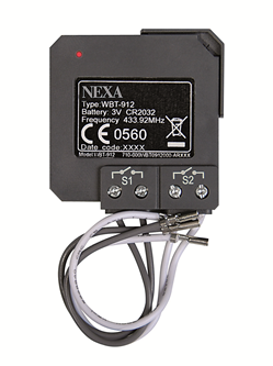

If you eventually would have a wireless receiver like the RFXtrx this type of module could be an alternative:

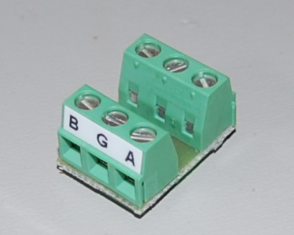

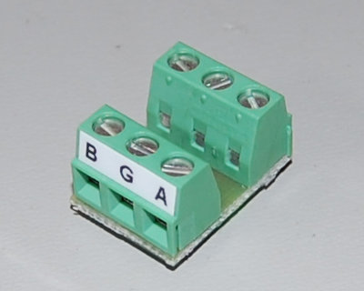

...and not to forget...the 1wire technology
A controller
and an input/output module
See this thread: http://eventghost.net/forum/viewtopic.p ... it=onewire
