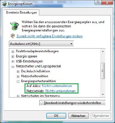

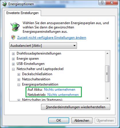

I don't know how the Captions are in english,
in the energy save options you have to switch of the "Energy Save Button" --> do nothing
but maybe this screenshot helps you:

Thank you so much!!! I thought I was going to be going deep into the registry, or editing DLLs or INIs, neither of which mean much to me. Plus I learned a little German. Thanks again!
