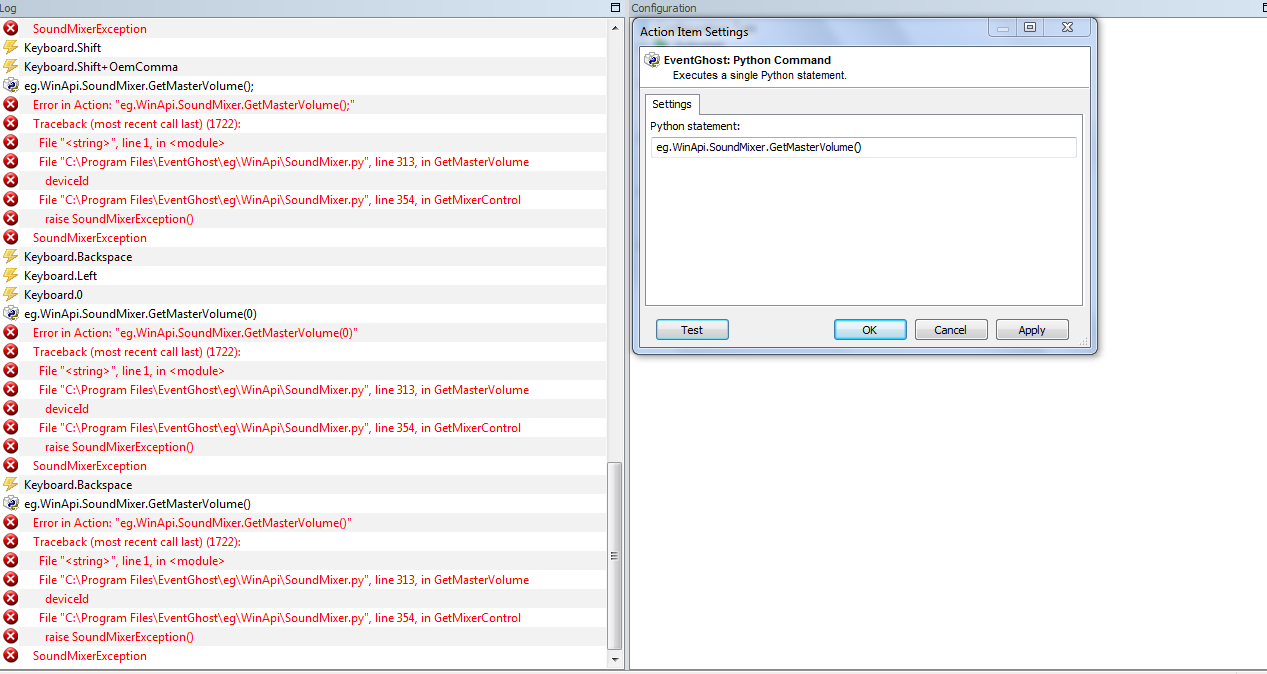

I am trying to get the current level of my volume on a win 7 32 bit computer and I am struggling with the eg.WinApi.SoundMixer.GetMasterVolume() function.
I have read a lot of threads and could not find any answer to the problem I have. I get an error message that says that there is a problem with the device ID. A screenshot is appended.. I tried a lot of different things to get it work and tried some workarounds but could not figure it out. Hopefully one of you can ;)
Error message
Error message

Thanks for your help guys. So what I did is I followed kgschlosser's instruction and to start with I could not get into the "help mode". When I type in help or help() the python shell tells me that the name help is not defined.
But I copied the for loop and extended the search from 0 to 1000. As a result I get that device 0 has a volume of 100. My current volume is somewhere around 20 so not even close to the maximum. I tried to find out my outputs device ID by looking into the device manager which did not help me. (The device name is IDT High Definition Audio CODEC btw and it says path 0 in its properties... )

Now I went looking and it appears as tho the eg.WinApi.SoundMixer is for pre Windows Vista computers. and VistaVolEvents is for Vista and newer. the reason why the system plugin works properly is because that is where VistaVolEvents has been coded in. So I have changed this and submitted the code changes. Hopefully it will be included in the next release of EG this way no matter what version of Windows you are running eg.WinApi.SoundMixer will function as it should.
Re: Problem with eg.WinApi.SoundMixer.GetMasterVolume()
OK the code for the changes to eg.WinApi.SoundMixer automatically running the proper code based on windows version has been added to the Core. so in the next release this will be functioning properly.
