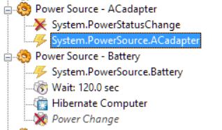

I'm using a Wait Action, so to your point (see attached), I could not execute actions/events in a different macro until this one ended.
Is it possible to add some type of If/then action, i.e. after the Wait period, if power back on ACadapter, stop processing?

ok using the wait for 120 seconds i am surprised that by using the wait for 120 seconds EG doesn't crash.
the use of the wait action is not to delay the execution of a specific task. what you would want to use is the timer plugin to do what you need. this will create a thread that in a pre defined amount of time will generate an event. and from that event you would have it execute the action you want. this also provides a mechanism to cancel the timer if an event gets generated tht would change the state back to it's original.
so as an example. you would want to create 3 macros as follows. The timer plugin will allow for EG to continue about it's way to do whatever it is it needs to. and when the thread that is running the timer countdown expires it will trigger an event and that is the event that you would use to run the hibernate action
Macro - Hibernate Timer
Event - System.PowerSource.Battery
Action - Timer Add Timer 120 seconds generates event Battery.Hibernate
Macro - Hibernate
Event - Battery.Hibernate
Action - Hibernate Computer
Macro - Cancel Hibernate Timer
Event - System.PowerState.ACadapter
Action - Timer Cancel Timer Battery.Hibernate
