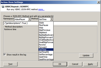

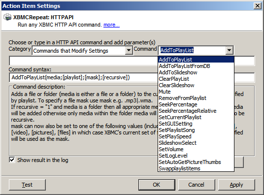

OK finally I'm finished with the next experimental/test version of XBMCRepeat, this time the new actions are a bit more useful then the last test version.I have added 3 new actions in an Experimental action group.
JSONRPC get more info here.
Just put any relevant parameters for a command in the parameter textbox. if you want to use results from a previous command, the standard {eg.result} wont work so you need to use this instead {{eg.result}} (double curly braces).
What a method returns varies, so the log option shows any results in EventGhosts log.

HTTPAPI get more info here.
Just put any relevant parameters for a command in the parameter textbox. if you want to use results from a previous command, the standard {eg.result} works.
The first time adding the HTTPAPI action you need to press the update button to download(from the internets) the list of current commands the current XBMC supports.
