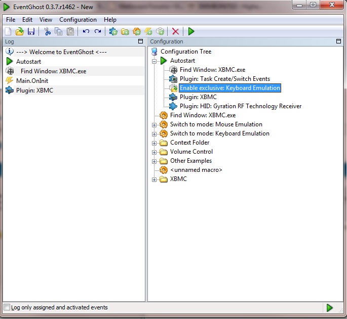

I don't know why. I added the plugin, but clicking the buttons still translates to actions happening in the main windows screen. What should my event tree look like, and what do i have to do to disable windows from picking up signals from my remote? Attached is new event tree. Appreciate the help.

Most likely what is happening is that your HID Gyration remote is also still sending button presses to Windows, it's the normal way how the remote is supposed to work. You need to stop that from happening. I don't really know how that is done (Since I don't have a HID remote of any sort), but I think you can find answers by searching the forum.

Well, I'll surely try to find that out. But regardless, when the window isn't in focus (when i'm doing other work), EventGhost doesn't seem to be passing the commands along to XBMC (which runs on the secondary monitor/HDTV). What can I do to make this work? I read about coding in findwindow commands, but have no idea how to go about doing that.

Do you see events appear in EG's log view when you push buttons on the remote? Have you mapped these to the actions cretated by the xbmc plugin?

Events definitely appear in log view. I'm a little confused as to how to "map" commands to the plug-in actions. Is it a matter of right-clicking? I saw something about dragging the log inputs over, but that didn't appear to work.

That's exactly what you should do.. drag and drop events from the log view to a macro you want to associate the event with. Whenever that event happens again it will run the macro.

As for how the plugin works, do you know if it's simulating keyboard commands, or is it sending commands directly to the program? Would it be possible to disable everything except for the XBMC plugin (ie - keyboard emulation), and still have it work?

The XBMC plugin uses a TCP/IP socket to communicate with XBMC. (xbmc has a remote interface for this purpose). I'm actually using an alternate "XBMC Repeat" plugin myself, it allows the remote to work exactly like with an xbox. You can find it here on the forum if you want to try it out.
I don't know what keyboard emulation macros you have enabled, but you won't need them if you use the actions from the xbmc plugin instead.
