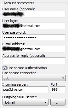

Re: E-mail
I was forced to create a hotmail account so I can try.
I have not seen any problem. This way account setup (as in the following pictures) is operating normally.
If you did not work, look for a problem such as a firewall.
- pop3_live.jpg (25.82 KiB) Viewed 10157 times
- smtp_live.jpg (16.12 KiB) Viewed 10157 times
Re: E-mail
Thanks for the quick reply.
I have tried your settings and unfortunately i still get the same connection error.
As far as i am aware, my settings are correct as they work ok in other mail apps.
I have also tried disabling my firewall and this makes no difference.
My hotmail account is a co.uk rather than .com if this makes any difference also?
Would be great to know if anyone else has had success using an hotmail.co.uk account?
Regards, J

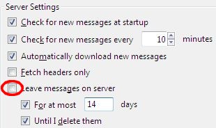

Re: E-mail
Unfortunately, POP protocol does not distinguish whether the messages are seen or unseen, if left on the server.
Set your e-mail client so that messages on server after downloading deleted.
For example, in Mozilla Thunderbird is setup as follows:Pako
