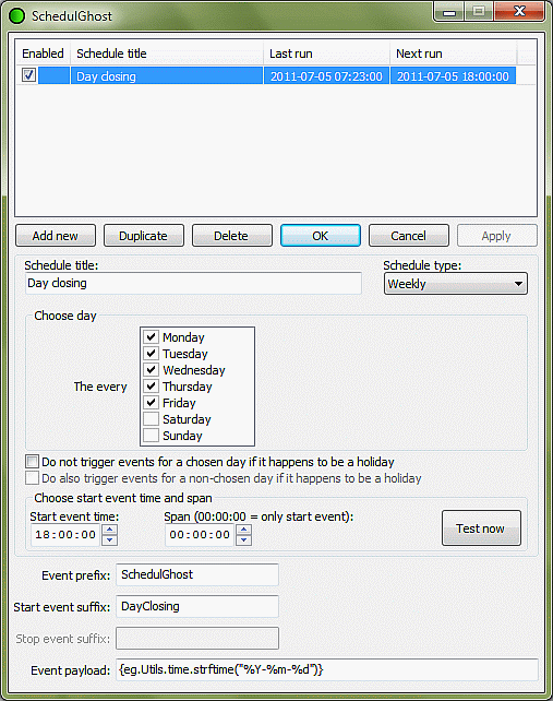

Yes, with EventGhost you certainly can solve your problem.
You unfortunately did not write what should be the date format.
One of the ways to get the date is here:

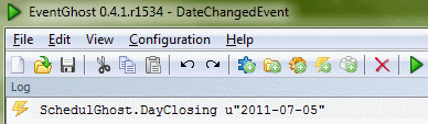

The event then looks like here:
You can use (in some macro) this date as eg.event.payload.
