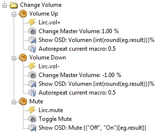

debennett2
Joined: Mon Jan 23, 2012 3:23 pm
Re: Using OSD and display current volume level [SOLVED]
Post by debennett2 »
FF.VolumeUp
   Change Master Volume: 0.50 %
      Show OSD: Volume - {int(round(eg.result))}%
         Error in Action: "Show OSD: Volume - {int(round(eg.result))}%"
         Traceback (most recent call last) (1544):
           File "C:\Program Files\EventGhost\eg\Classes\ActionBase.py", line 170, in CallWrapper
             return self(*args)
           File "C:\Program Files\EventGhost\plugins\EventGhost\ShowOSD.py", line 385, in __call__
             osdText = eg.ParseString(osdText)
           File "C:\Program Files\EventGhost\eg\Utils.py", line 204, in ParseString
             res = eval(word, {}, eg.globals.__dict__)
           File "<string>", line 1, in <module>
         TypeError: a float is required
      Autorepeat current macro: 0.6
Any ideas? This is in a Windows 7 machine. I'm lost.
debennett2 wrote: I'm lost.
I'm also lost.
I need to see not only the result but also a source or originator of it.
Why are you here did not give either a screenshot or your configuration file?
Thus, it seems that there are missing the action Change Master Volume.
It must be before the action Show OSD.
InterlinkKnight
Posts: 29
Joined: Mon Sep 13, 2010 1:17 am
Post by InterlinkKnight »
Pako wrote:Why are you here did not give either a screenshot or your configuration file?
I was thinking that you can do it yourself, with your own "change master volume". I mean, this is to show the volume, not to make a volume change button. Anyway, you are right. I better place the configuration file in here just in case anyone is lost:
<EventGhost Version="1544" Guid="{93CA3DF2-7148-4B9C-9F06-FB3D578935B9}" Time="1327405609.27">
    <Autostart Name="Autostart" Expanded="True">
        <Plugin Identifier="Lirc" Guid="{17A77662-BB69-4C37-AA43-71213958C5C4}" File="Lirc">
            gAIoWAkAAAAxMjcuMC4wLjFxAE09IomJiUsAS8iIS0BLCnRxAS4=
        </Plugin>
    </Autostart>
    <Folder Name="Change Volume">
        <Macro Name="Volume Up">
            <Event Name="Lirc.vol+" />
                System.ChangeMasterVolumeBy(1.0, 0)
                EventGhost.ShowOSD(u'Volumen {int(round(eg.result))}%', u'0;-64;0;0;0;700;0;0;0;0;3;2;1;34;Arial', (255, 255, 255), (0, 0, 0), 5, (0, 100), 0, 3.0, True)
                EventGhost.AutoRepeat(0.5, 0.20000000000000001, 0.029999999999999999, 0.0)
        <Macro Name="Volume Down">
            <Event Name="Lirc.vol-" />
                System.ChangeMasterVolumeBy(-1.0, 0)
        <Macro Name="Mute" Expanded="True">
            <Event Name="Lirc.mute" />
                System.ToggleMute()
                EventGhost.ShowOSD(u'Mute {("Off", "On")[eg.result]}', u'0;-64;0;0;0;700;0;0;0;0;3;2;1;34;Arial', (255, 255, 255), (0, 0, 0), 5, (0, 100), 0, 3.0, True)
That solve your problem?
configuration
configuration
ScreenShot - 2012-01-24 - 07.24.11 - 001.jpg (35 KiB) Viewed 10853 times

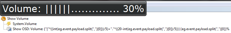

Vilsepi
Joined: Fri Aug 10, 2012 8:48 pm
Post by Vilsepi »
First of all, thanks for everyone for this thread. I've been using EG for a couple of years but for some reason I've been neglecting the OSD completely. Today I started to come up with a simple volume OSD.
bskchaos wrote:The new event (system.volume) seems to be accurate and I want to use it for a better volume bar.
Right now I need to convert the eg.event.payload to a number, need help with this.
That's what I also wanted to use (didn't actually know any other alternative). My problem with System.Volume was that the payload is a string, depicting a float/double with a comma as a decimal separator. Having the comma instead of a period is what seems to fail the type conversion, thus I simply split the string from the comma and take only the numbers before it:
Value only:
Volume: {eg.event.payload.split(",")[0]}%
Volume bar (100 characters long, made of | and .)
Volume: {"|"*int(eg.event.payload.split(",")[0])+"."*(100-int(eg.event.payload.split(",")[0]))}%
Shorter volume bar (20 characters long, made of | and .) with numerical value in the end
Volume: {"|"*((int(eg.event.payload.split(",")[0]))/5)+"."*((20-int(eg.event.payload.split(",")[0])/5))}%
Webdings bar (20 characters long, made of blocks), make sure you set font to Webdings!
{"g"*((int(eg.event.payload.split(",")[0]))/5)+"c"*((20-int(eg.event.payload.split(",")[0])/5))}
Webdings bar (50 characters long, made of blocks), make sure you set font to Webdings!
{"g"*((int(eg.event.payload.split(",")[0]))/2)+"c"*((50-int(eg.event.payload.split(",")[0])/2))}
Hope this helps. It could be a bit too heavy, I dunno, but I think I might be going with just the numerical display.

Ascii volume bar with numerical value
Event payload has a float with a comma-separator
