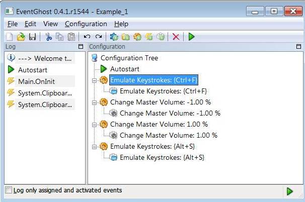

I am trying to emulate keystrokes using MCE remote, but it is not responding. I am using Microsoft MCE Remote - Vista/Win7 plugin where the reciever is Microsoft eHome IR Tranciever. Am I missing something, please help.

I explain what I am doing clearly. I am trying to use EG with MCE remote. However, I am stuck even when I am not using MCE plugin. That is when I press the green play button for volume it works, but it is not working for the rest of the emulation such as {Ctrl+F}. Could there be more action or event need to be added? If I can get this working I will be using MCE remote eventually. Please take a look at the image file. Appreciate any help. Thanks.

Have you tried "Uninstall Service" then "Install Service" for the AlternateMceIrService in the plug-in's configuration?
Re: Keystroke emulation with MCE remote
The mistake that I made was not adding a trigger, and only realised after seeing similiar posts. It is working fine now.
