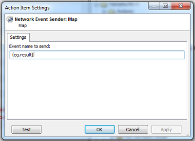

Let's say I use the action Basic_Input_Sel to retrieve the input information from the receiver. How then do I send this information via the network event sender plugin?
Dragon470
Posts: 205
Joined: Thu Feb 10, 2011 2:16 am
Re: Yamaha RX-V867 (or similar) Ethernet Plugin!
Post by Dragon470 »
You have the Get Basic Input Sel.
Your next Action is Network Event Sender: Map
in the config screen you type in {eg.result}
This will send only the exact information.
