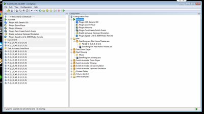

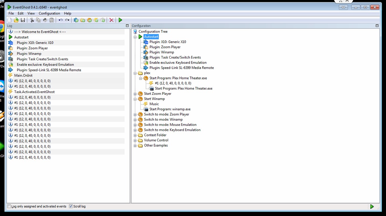

many thanks for the reply and maybe I am missing something. I have tried binding the command to a macro. In this case when I push the green window button it should start plex home theatre but nothing happens. I have included a screenshot. There is an exclamation mark next to the event which I assume in EG means it doesn't know what to do with t6he keypress?
Any help appreciated.

Well, that's an upside down exclamation point, also known as an i.
I believe it stands for Information, and is not a valid Event, unfortunately. I don't know anything about that plug-in, so am not sure if if this is a bug or it wasn't designed to pass the Green Button. If there's another button you're not using, you can use it as the triggering Event.
Edit: It might be a hardware issue. According to this post, some hardware versions don't support Start, amongst other keys.
Edit2: Perhaps there is some help for you here.
