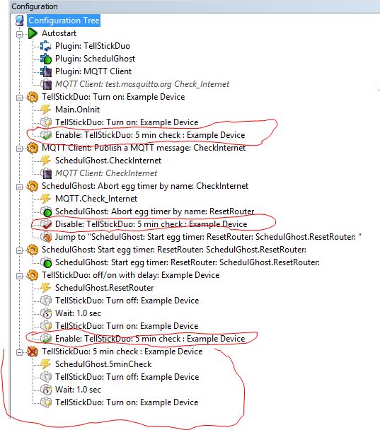

Yes, this can be made. See picture below (Also, check the updated guide!). What I have added isif no connection is made for let say 5 minutes, is it possible to make another restart of the modem again, and so on
- one additional 5 minute timer (configured in SchedulGhost)
- a macro for the 5 minute check
- some enable and disable actions to control when the 5 minute check may apply
As you see, I also enable the 5 minute check when Eventghost starts up in case there should be an initial problem with internet
PS If you think that the configuration tree now is starting to look too messy/complex, you can always create a folder 'Internet Check' and move all those macros inside
