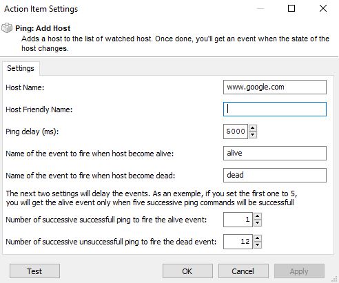

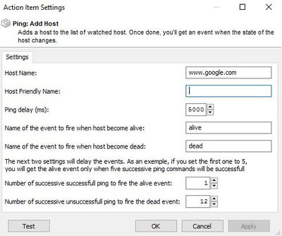

Use Add Host action, try with www.google.com
Re: looking for an plugin.
With the Ping plugin, I have configured the 'Add Host' action like below. You should give enough time for the checks to avoid false alarms. Remember that your internet connection might be fully operational also in cases where the host is not responding. Therefore you should select a host that is likely to be available 365/24/7
