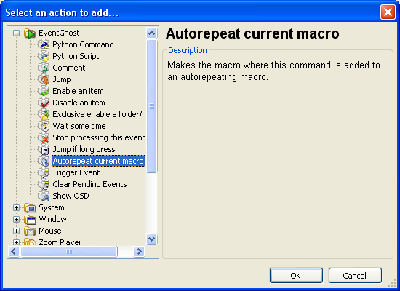

In actions:
EventGhost -> Autorepeat current macro

Re: config a button to auto-repeat while keep it pressed, how?
thxz for your reply. That did the job!

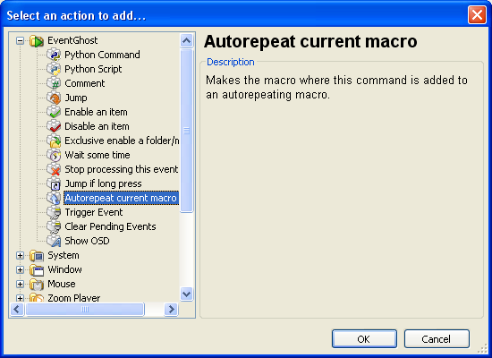

I am using version 0.3.7 and for me works better, than previous versions. But I am not using a USB-UIRT.hal wrote:Do you recommend a version that is stable and that perhaps my Auto-repeat bug will be fixed?
When you not to use the latest version, you can use, for example, version 0.3.6.1487.
Try Autorepeat configuration according to the attached image.
- Autorepeat.png (8.57 KiB) Viewed 9167 times
