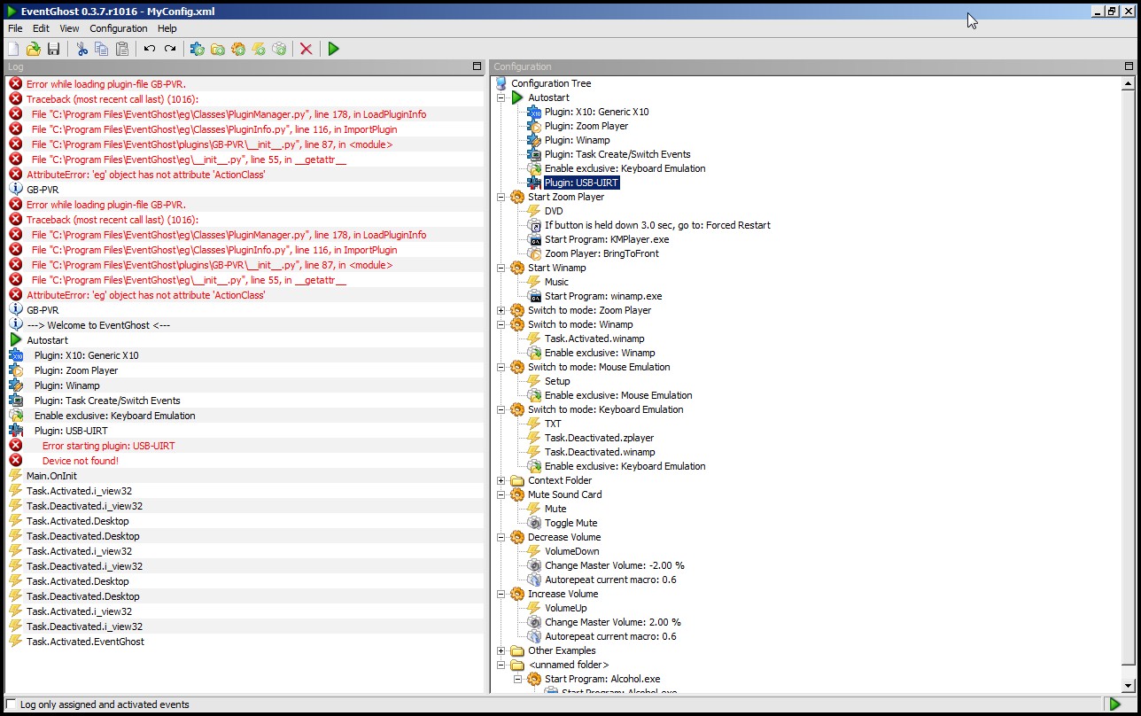

When I plug the IR remote receiver to computer, I see some entries in window log like : "System.DeviceAttached[u'\\\?\\USB#VID... " and "System.DeviceRemoved...". But when I try to install plugin USB-Uirt, the log shows : "Error starting plugin: USB-UIRT. Driver not found!". Do I something wrong? Maybe I have to install some other plugin...?

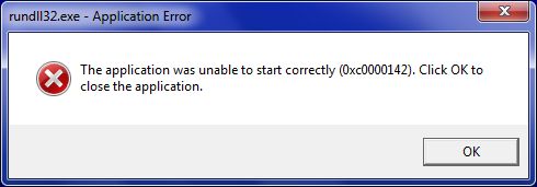

I've installed this : http://www.eventghost.org/downloads/x10drivers_x86.exe, but after install (when I click OK 'Installed successful" window) I see this :

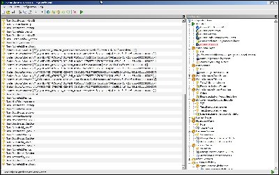

and when I start EventGhost :

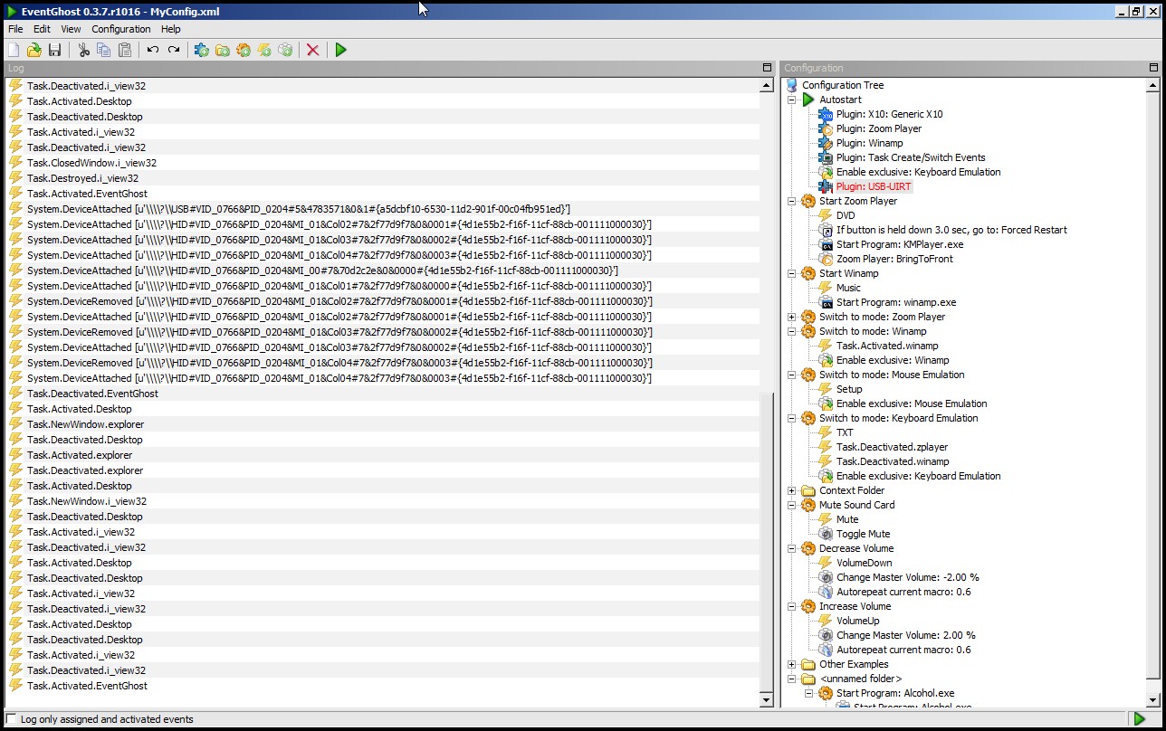

I've got that remote and it works great. It is actually a generic hid device. So go to add a plugin and install generic hid and it should come up with a list of of things. The cyberlink remote was classified as a HID Mouse by TopSpeed Tech Corp. There should be a few of them, some buttons are under one profile while the others are in another, so you have to add a couple plugins, and you probably will want to check the option for raw data or put an event prefix, because the non-raw codes overlap. Hope that helps.

It took a while to figure out but I found that if I added plugins for the three Topspeed Tech HIDs and set them all to RAW with prefixes of 1,2,3 then button presses started showing up in the event log where they didn't before. I then right clicked the plugins and used configure to set them back to 'trigger' (leaving the prefix) and the events started showing up as 2.button1 etc.
I then added a keyboard plugin and could see more or less every button press in the event log. All good. :)
