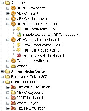

You need to "enable" only what is in use at the time VLC or XBMC... so use the Exclusive Enable action to enable the key commands for which ever is in use.
The example folders in the default install shows you how.
See my example of enabling/disabling XBMC keyboard commands based on if XBMC is running or not.

Hi there and thanks for the reply. I have a question regarding my setup. As I understand, I create a folder that contains macros and create a macro on the same level to give the new folder exclusive rights. So...as long as the task is running in focus, all commands within it's associated folder is active. Is this correct?
1. When I am in EG and press Enter, the log shows that it is running the XBMC:Select command. The XBMC window isn't activated, neither is XBMC running at all. I am confused.
2. If I minimize EG to the taskbar and remaximize it, my folders and macros are disabled.

Re: Getting EG to play nice with XBMC
you have a conflict... Task.Activated.Desktop triggering both macros
Actually no. Just a typo when cutting/pasting. I wasn't able to add a screen shot but I have task.activated for both the system tools and XBMC.
