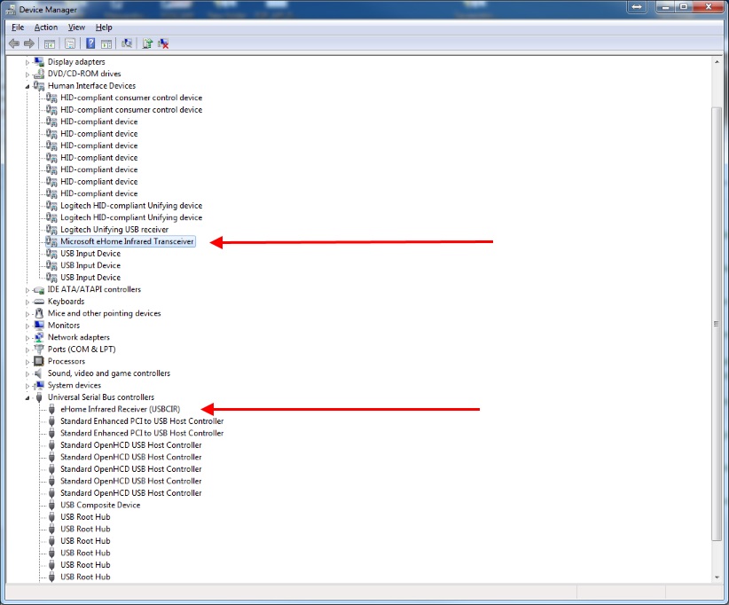

do you see either of the 2 items below in your device manager???
if so you should be using the MCE remote plugin for win Vista/7
all depending on how the drivers are installed for the Tuner if it adds the remote IR receiver as a USB device . i had a similar issue and i would have to uninstall the drivers (not delete them and then do a scan for new hardware and it would start working again. it turned out to be something completely unreleated. it was the amd filter driver (from my video card drivers) causing the problem. when i removed the registry keys for the filter driver it stopped doing that. and it would only be when the computer went to sleep and i woke it up
took me forever to nail down the cause of it. but it sounds so similar to my problem i thought i would mention it. and as far as EG goes and seeing multiple devices it could be because it doesn't see the other get removed (because it's stuck).
