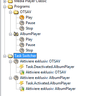

Yes, EnableExclusive is an action in EG and the task plugin is a standard plugin. Just add it to your EG config and you will receive events when switch apps. These events can you use to trigger a EnableExclusive. With EnableExclusive you can enable/disable a folder in EG config tree.
Here is how it could look like:

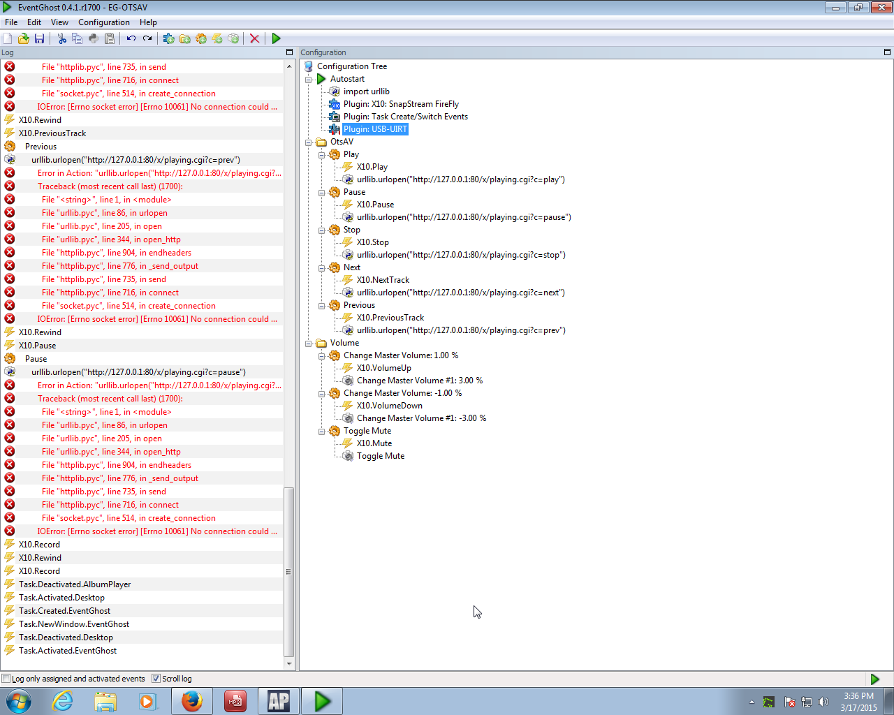

This is where I'm at, I unzipped the AlbumPlayer.zip file into the above folder and please see a screenshot of the config tree, next?
[attachment=0]2015-03-17 15_36_39-Greenshot.png[/attachment]

Now you need to add the plugin to EG and create macros for the actions you want to have. http://www.eventghost.net/docs/
