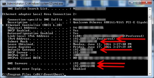

here are some screen shots of what i am describing.
the first is the ipconfig and the information needed from it.
i have red arrows pointing at the things. but on this won i also included the dns servers just in case you want to use your isp's

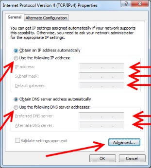

this next one is the ipv4 properties

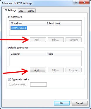

and the last is the advanced button
2nd ip address.jpg (32.32 KiB) Viewed 4185 times
