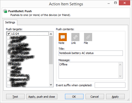

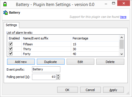

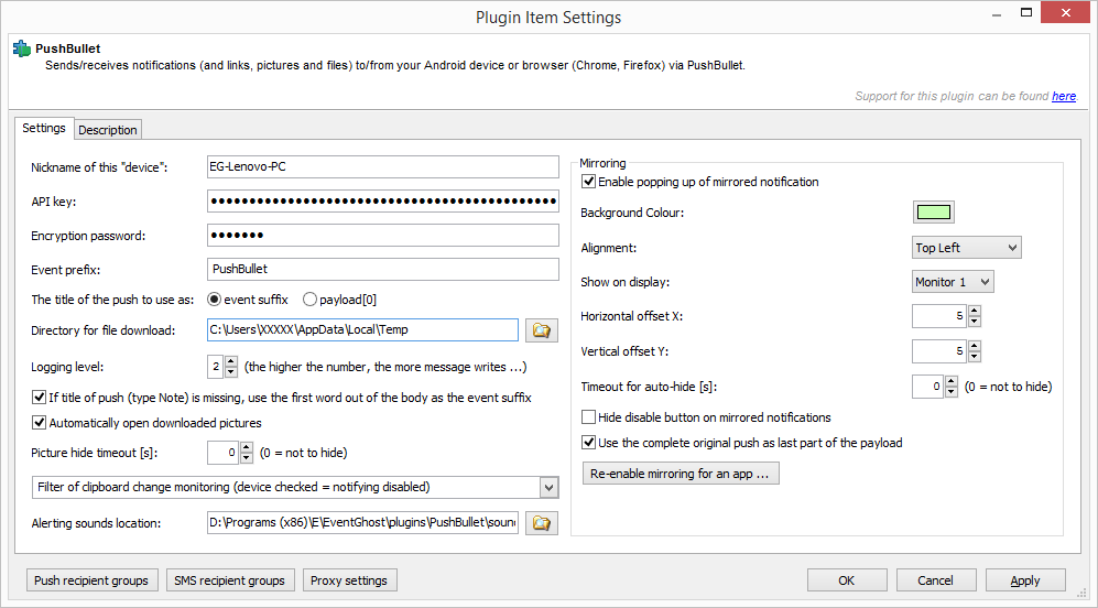

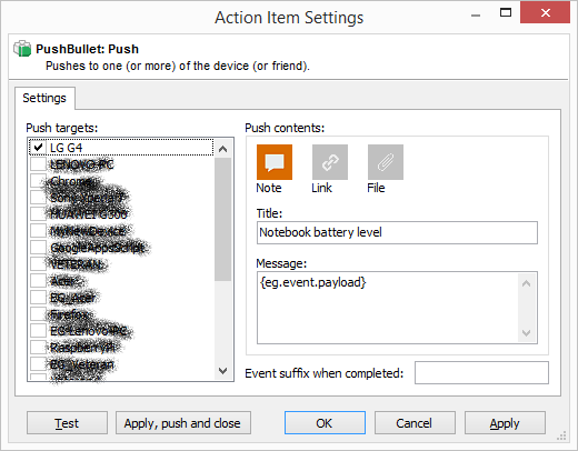

Well, here is a series of pictures that should help you.
Tasker setting I can add too, but it very much depends on what type of notification or action you need. Anyway it's also easy, because there (I mean Tasker) Pushbullet plugin is also available.

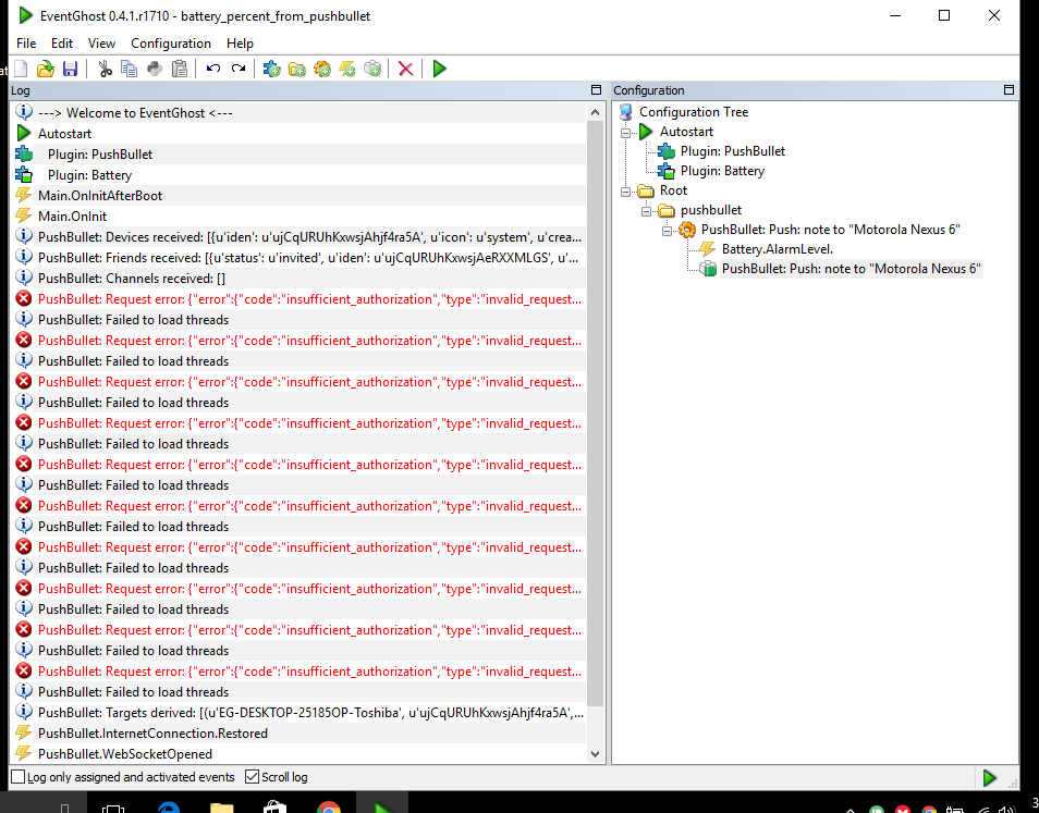

Still having troubles... Is it normal to load with error's when i first start Eventghost? If i highlight the "PushBullet: Push: note to "Motorola Nexus 6" " and click the green icon (to manually run it) I do get a pushbullet notification of battery %. However... When I minamize eventghost (keep it running in the background... Do NOT x off) If I set the battery plugin to 97% and unplug my laptop, When the battery reaches 97% (manually watch it by clicking the battery icon every so often) I do not get the pushbullet notification..
I believe I've set things up as per your pics

In your setup, an ending * is missing in the label for the event
Re: Battery level %
Krambriw is right - asterisk (as a wildcard) is missing in your setup.
However, I see another problem - the red lines in your log.
Maybe it could be a problem with encryption. You have enabled encryption? And if so, for all devices the same passwords set?
You have installed the Chrome extension and / or desktop Pushbullet application too? Its works smoothly?
