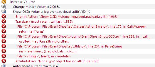

@Vilsepi
Tried it but i am getting error
check the attachment
also want to tell you that used all of the above doesn't work
What i use currently is this
Volume {'|'*int(round(eg.result))+'.'*(100-int(round(eg.result)))} {int(round(eg.result))}%
works perfectly for me on windows xp sp3

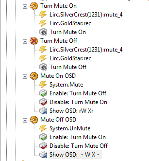

I've played around with the OSD and I'd like to share my observations and my volume bar.
First for the mute/unmute Webdings characters
Xr and X├░
"X├░" is not working for me (Windows 7 x64, System Locale: Bulgarian) But I found that inserting the character in Microsoft Word from the Webdings character map and then copy-pasting it in notepad produced the character:
´â░
which worked for me! It appears blank in this forum, as two vertical lines in Notepad and as a dot in EventGhost.
Second for the colored mute/unmute:
This way you get two different OSDs for the two posible positions and making a new macro for the System.Mute and System.UnMute events guarantees that the OSDs will be shown regardless of how you mute the PC - by a remote control button, by keyboard button, by left clicking the mute icon etc.
Example output:
